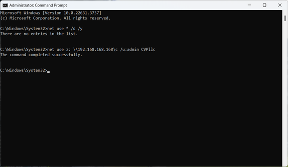

Here's the results of the cmd window. What was supposed to happen?
The data volume should now show up in file explorer as the "Z" drive. So look on Z for your files.

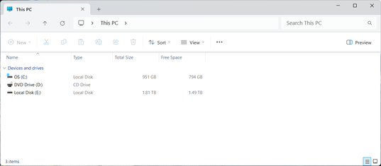

Got the computer back up and running. There is NO "Z" drive listed.

The Z drive mounting wasn't persistant, so the two "net use" commands above would need to be re-entered in order to see that again. BUT, the credential manager did work, as you are now able to browse all the folders.
I reentered the commands... still no Z drive.

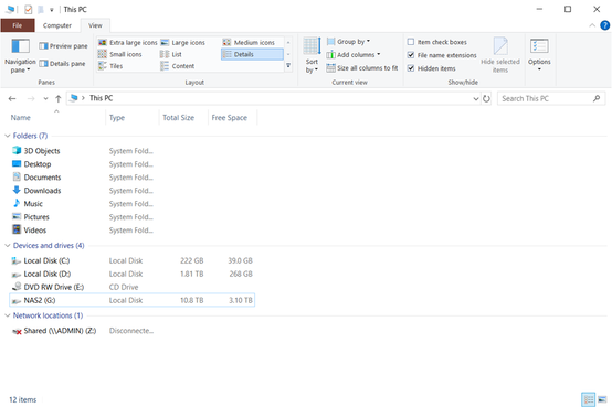

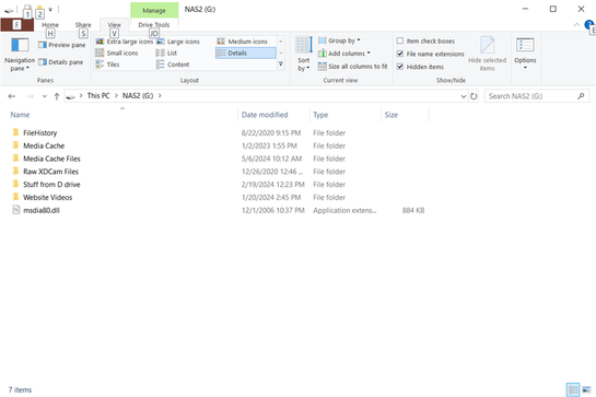

These are screenshots from the G Drive listed on the old workstation...
As you can see... there is LOTS of data on the NAS.

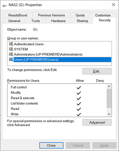

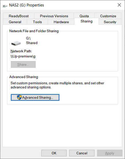

Also, since you still have the old workstation, I suggest connecting ethernet from LAN port 1 of the NAS to that workstation, and take another look at the G drive.

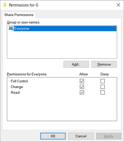

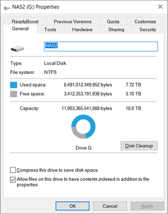

Here are some other sharing properties for the NAS2 (G:) on the old system...
And here is how it is connected...
I now have the NAS hooked up to both machines via ethernet cables. Let me know if you need to look at something else on the old machine.
Thanks!

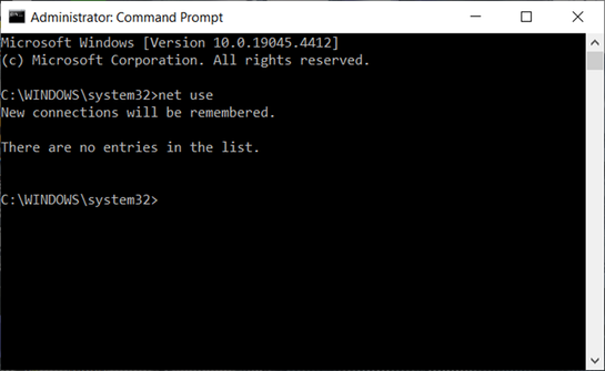

Run cmd on the old workstation and then enter net use
Then post the output in a reply. That should show the network path that was used to mount it. Which is where your data is.
- CustomVideoLLCJun 19, 2024Tutor
Hey Stephen,
No dice there...

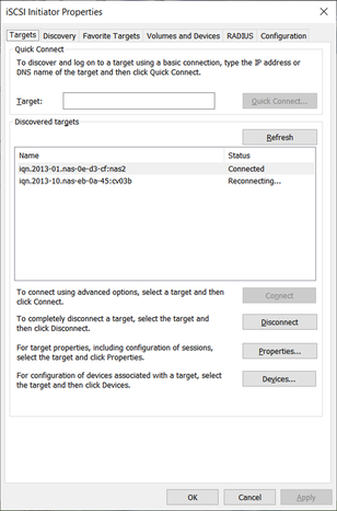

Doesn't the fact that it is listed under "Devices and drives" and not " Network locations" mean anything? It says it is a Local Disk. And the connection is named iSCSI?
Thanks!
- StephenBJun 19, 2024Guru - Experienced User
The iSCSI bit matters for sure. Honestly I haven't done much with iSCSI, and I don't have any systems running 4.2.x firmware.

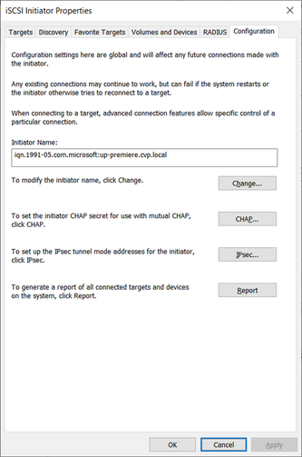

It is a bit odd that the network path starts with \\Up-premiere, since that is not the name of the NAS. It could be a manually entered hostname. I am guessing that the iscsi target is g based on the Window property screen, but I am not 100% sure.

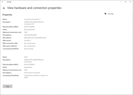

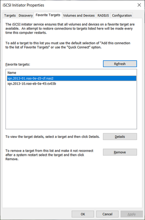

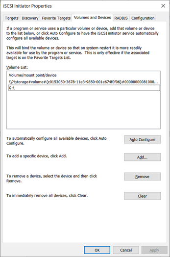

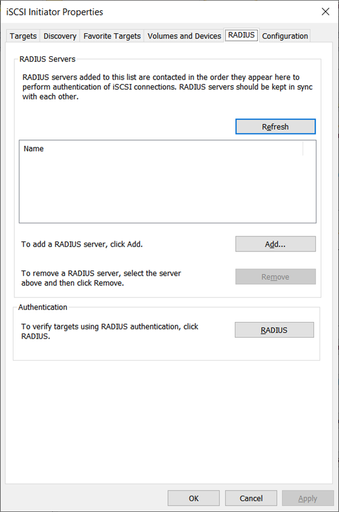

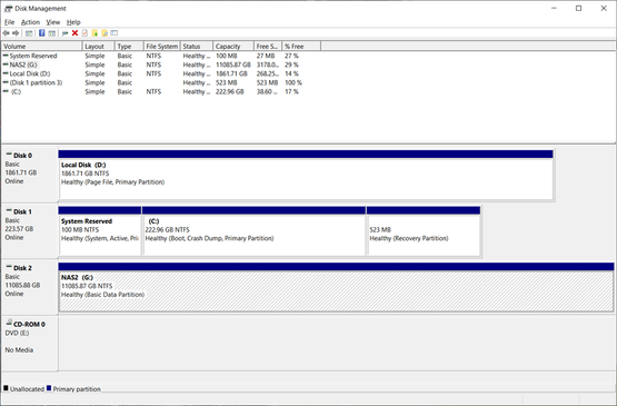

Here is the Disk Management screen from the old workstation...

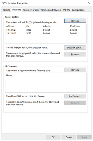

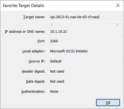

I couldn't find "Volume Settings", but I did find the iSCSI Initiator Properties. These are the windows....
Does any of this help?
As far as the \\UpPremiere, when this was all first put together, we had a server and a few workstations, plus two NAS boxes at the time. One was attached to each workstation though, same as now, with a yellow ethernet cable. I don't have the server anymore, not for more than six years. Like I said, the NAS just kept on working as an external drive, so I just kept using it that way.
Thanks!
FYI, I was asking you to look on the NAS (in frontview - the NAS web ui), not in Windows.
There are two paths to proceed.
- stay with iSCSI and attempt to create an iSCSI Initiator on the new PC that points to the NAS.
- switch to using normal shared folders.
So far it's been tough sledding. (1) likely would continue to be challenging. (2) is simpler, but would require copying all the data off the NAS, destroying the iSCSI LUN on the NAS to free up space and then copying tthe data back.
So I am not sure which way is best.

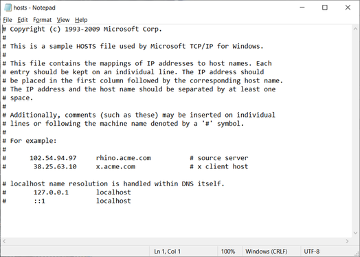

Is UpPremiere defined in the Windows hosts file (c:\Windows\System32\drivers\etc\hosts)? If it's not, then it may be the name given to the iSCSI pool.

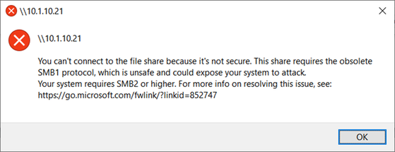

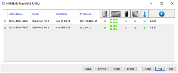

Good Morning!
I could not open frontview on the old system. This is the screen I got from RAIDar...
When I clicked on browse, I got this...
I tried to connect to the NAS via Firefox, which I already had on that system and I couldn't connect. I kept getting the "This site is asking you to sign it" window, but admin and netgear1 would not work. Just kept coming back to this same screen.
When I cancelled the window, I got an "Authorization Required: This server could not verify that you are authorized to access the document requested. Either you supplied the wrong credentials (e.g., bad password), or your browser doesn't understand how to supply the credentials required."
In response to Sandshark... This is what I got when I opened the "hosts" file...

- schumakuJun 20, 2024Guru - Experienced User
No, it's the name of the iSCSI initiator, so the iSCSI "client" in SMB or SAMBA or Windows File Share terms.
The name of the target is certainly in the same config ... NEO ... in the Target tab. 8-)
Back then, using iSCSI wasn't bad decision when it came to video online editing.

- StephenBJun 20, 2024Guru - Experienced User
What was bad is that the tech didn't leave any documentation/records on how he set the system up. We still don't know whether authentication is used or whether the LUN is encrypted.
