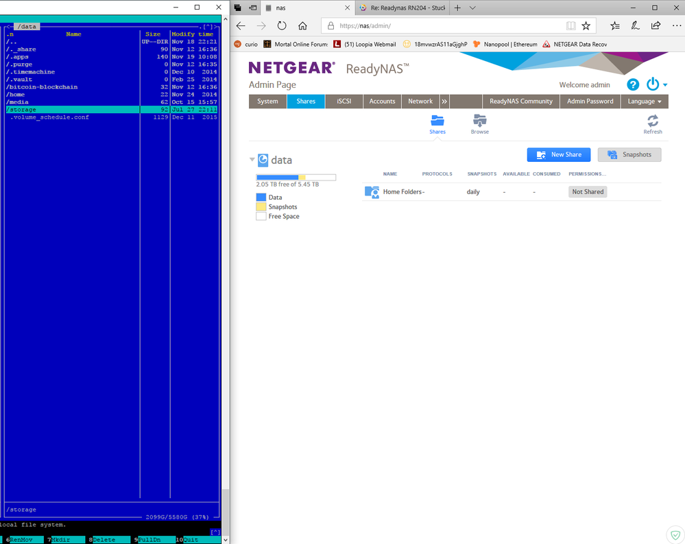

/bin/mount /dev/disk/by-label/1177b17c:data /data -t btrfs
- davor242Nov 19, 2017Aspirant
After 80 minutes, boot finishes.
This time volume is there, but shares are not. Interestingly, shares can be seen from SSH.

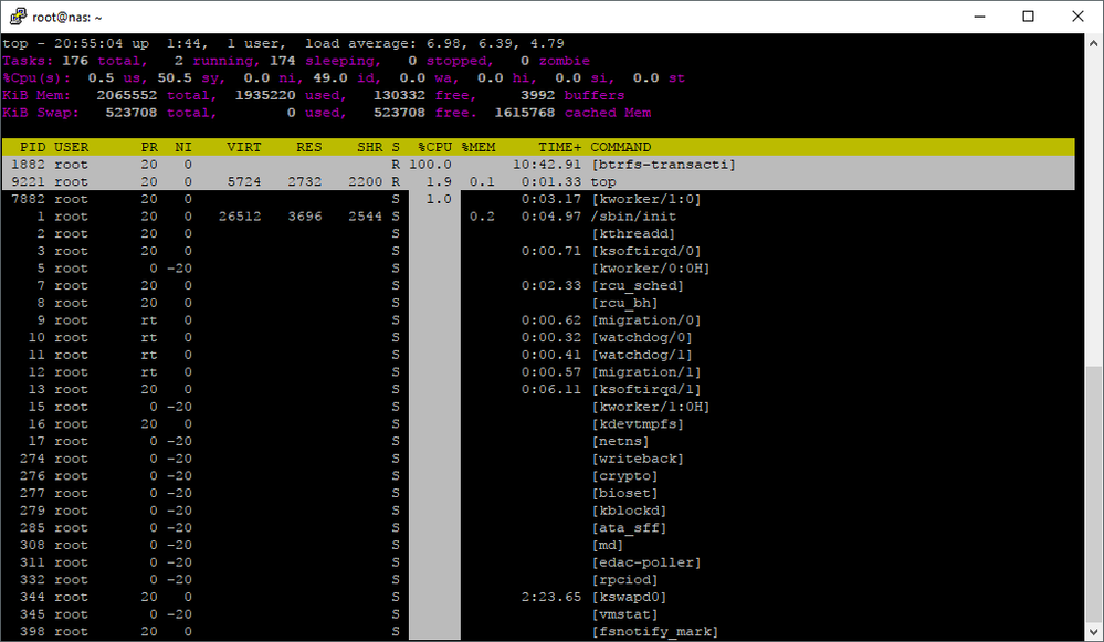

Is top telling you what the mount command is doing? The "c" toggle should give you it's command line.
davor242 wrote:
In essence, I believe there are issues with iSCSI implementation. :/
Clearly something is wrong, but I don't think you've isolated it to iSCSI just yet. Lots of things will misbehave when the system is running at 98% CPU.

I have created a new LUN with thick privisioning and moved data there. This seems more stable, however iSCSI dropped out again (normal shares work fine).
What I have noticed is that every time the iSCSI drops the btrfs-transacti is running at 100% (i.e one core full load).
The btrfs-transacti will eventually calm down and iSCSI pops up again without NAS restart (although Windows may or may not be confused at that point and PC restart may be necessary, have not kept track of this fully).
So my current guess is:
* Something triggers this btrfs storm
* This affects iSCSI which drops
* Restarting the NAS at this point should be avoided
I am guessing that this btrfs-transacti is doing something useful. But I would consider dropping the iSCSI as a product bug.
