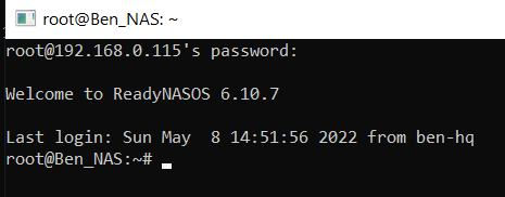

FileZilla only does file transfer (SFTP). You could try entering ssh [email protected] into the windows search bar, and see if that connects. Try both the old and new admin passwords. You will get an authentication prompt the first time you try this (related to the ssh fingerprint).

Using the ssh [email protected] option, the CMD window just hangs and remains blank, therefore there is no prompt for Username / PW.

Sorry, I meant ssh [email protected].115 (the IP address of your NAS).

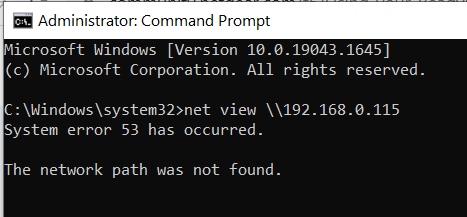

Also, run CMD, and enter net view \\192.168.0.115 Normally you would see the share list - let us know if that is the case. Be careful to use the correct slash direction in this command.

Apologies, I misunderstood - this time I was able to access via SSH and using 'password', I think it has let me in;
Netview did not appear to work;
