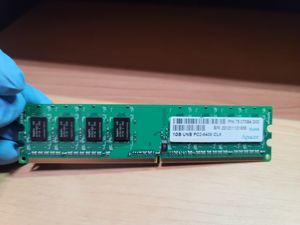

Hopefully this time it's posted on the Readynas community webstie.I have an Readynas Ullra 6 (RDNU6000) with 6x3TB installed. RAIDiator ver 4.2.31. Flex-RAID level-0. After viewing post from Mook1 "...

I was thinking the same thing. I'm going to pull out the motherboard again and take a look at the connectors. But when I initially changed the RAM, I was able to remove the original RAM stick and install the replacements WITHOUT disconnecting anything. What I noticed was after I restalling the MOB and covers, when I went to reset the nas, depressed the reset button with the paper clip, I DID NOT hear a click. I'm speculating that when I went to slide the MOB back in place, it may have not centered in the small hole properly, even though can clearly see it centered from the outer back plate. When I turned the power switch on in the back, above the power cord, it was already in the Boot menu. After I powered down the nas to stop the memory test (5hrs), when it rebooted, it went right back to the Boot menu. I press the back button to select "Normal" boot and press the reset button to confirm but it did not exit the Boot Menu.
