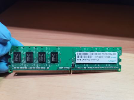

I was thinking the same thing. I'm going to pull out the motherboard again and take a look at the connectors. But when I initially changed the RAM, I was able to remove the original RAM stick and install the replacements WITHOUT disconnecting anything. What I noticed was after I restalling the MOB and covers, when I went to reset the nas, depressed the reset button with the paper clip, I DID NOT hear a click. I'm speculating that when I went to slide the MOB back in place, it may have not centered in the small hole properly, even though can clearly see it centered from the outer back plate. When I turned the power switch on in the back, above the power cord, it was already in the Boot menu. After I powered down the nas to stop the memory test (5hrs), when it rebooted, it went right back to the Boot menu. I press the back button to select "Normal" boot and press the reset button to confirm but it did not exit the Boot Menu.

I just took off the covers of the NAS to double check that the connections on the MOB where not loose. The connections were fine. I brought over the NAS to my work bench to make certain I was able to hear the click sound when I pressed the reset button. It was able to this time hear the click. I held the reset button and then powered on the NAS and select ed "Normal" boot. It did reboot but STILL GAVE ME THE SAME ERROR MESSAGE "NO DISKS DETECTED". I have nearly 16TB of media in this NAS. The only positive side is that I have everything backed up on physical raw hard drives in my closet. From this point, I don't know what else to troubleshoot. Any suggestions and or tips is highly appreciated. It has been a very strenuous 2 days with this problem.
