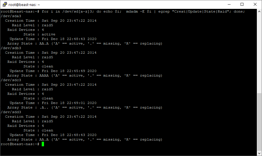

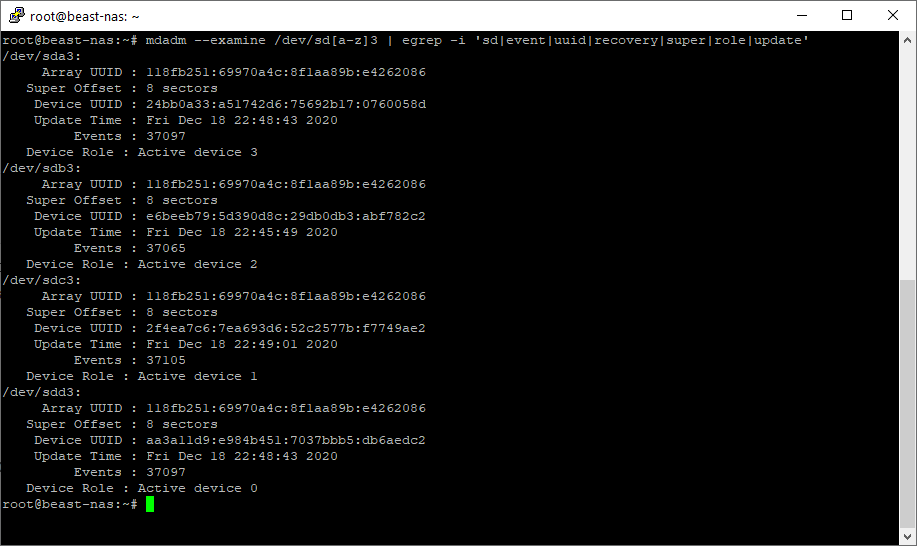

# for i in /dev/sd[a-z]3; do echo $i; mdadm -E $i | egrep "Creat|Update|State|Raid"; done; # mdadm --examine /dev/sd[a-z]3 | egrep -i 'sd|event|uuid|recovery|super|role|update'
If you want to check the state of the RAID running one of the above commands should indicate the state of the data volume RAID for each disk. It sounds like you probably have at least three different update times or multiple disks with each of at least 2 update times.

I don't want to risk loosing any of the data so I'm going to attach all 4 drives to my main PC and run a recovery software as suggested by StephenB. If the data can be recovered I'll backup the data to a new NAS which I'll order over the weekend.
mdgm I've ran your scripts and as you correctly mentioned the "Update Time" is different on 2 of the disks. It also appears that some disks think the array state is missing a disk:
