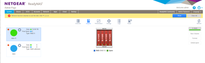

When I access my device, the admin page appears as follows:
The disk status looks healthy (ATA Error=0) for 3 disks but the disk in slot 2 shows ATA Error=13

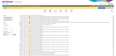

  • See below an extract of the error log
    ...and the key messages summarised here:
    Sun Apr 23 2023 21:54:54
    Disk: Disk in channel 1 (Internal) changed state from ONLINE to FAILED.
    Mon Apr 24 2023 4:18:46
    Volume: Volume data is Degraded.
    Wed May 3 2023 18:07:45
    Volume: Volume data health changed from Degraded to Dead
    Wed May 3 2023 18:07:46
    Disk: Disk in channel 2 (Internal) changed state from ONLINE to FAILED.
    Wed May 3 2023 18:08:29
    Disk: Detected high uncorrectable error count: [56] on disk 2 (Internal) [ST4000VN000-1H4168, Z300TWD3]. This condition often indicates an impending failure. Be prepared to replace this disk to maintain data redundancy
