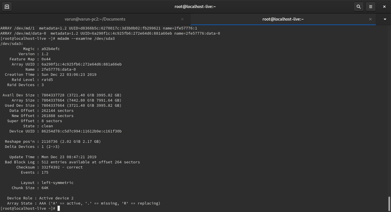

I had a NAS (RN104) with 4TB capacity (2x4TB) with x-raid configuration. I was assigned the task to increase the capacity with two more disks provided of 4TB. Accidently I messed up with raid configuration and lost the volume/raid configuration on those disks and have urgent requirement of restoring the raid md volumes and get the data back.
Current Status: When I boot the NAS with original disks, it gave error of "data degraded" on the screen. It looks like the definition of "data" volume also lost in the process.
I took out both the drives and connected to one of Linux (Fedora) system. I can see the software raid partition on that drive and md volume but inactive. Is there a way I can mount this volume on Linux and access my data from there. Attached are few outputs related to that. md125 (sda3) is the volume I guess which holds the data. Please help.

      Did the expansion finished before this happened? it would be best if you can send us the full logs on a shared link. You can PM it to us.

        Thanks for looking into this. Unfortunately logs are not available now. There was a requirement of shares availability and someone reset the whole NAS device and rebuild the OS on new drives.
        However when I had discussed with the person who was working on it and I am completely sure that expansion was not completed. When the new drives were added, it started re-sync process which was interrupted and never completed. I recently discovered that someone disabled the x-raid also (hoping to create a new volume on new added drives) and since then it has this issues.
        Right now I have those two drives with me which were in x-raid (raid1) configuration earlier. I am hoping that I could mount the md raid volume in Linux and access the data from there.
        I can provide more outputs from that drive if that helps. Sorry I have only limited data to provide here.
