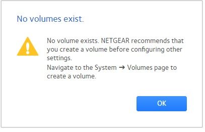

Hi,
I have a Readynas RN10400 with firmware version 6.10.8

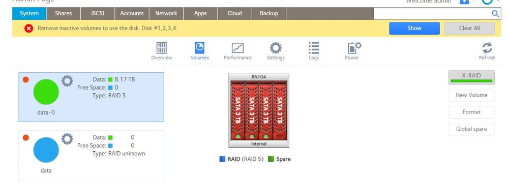

It has 3 x Seagate NAS ST3000VN000 and  1 WD Red NAS disk drives configured with X-RAID but since issue the system shows RAID 5 and zero free space.
After not able to access the my files one the NAS, logged into the web browser UI with admin and got the no volumes exist, pop up.
Pls help
Tom

8 Replies
  • StephenB's avatar
    StephenB
    Have you checked the disk health?  (best way to to download the log zip file, and look in disk_info.log).
    Was the NAS unexpectedly shut down recently?  A power outage, or maybe someone pulling the plug?
    • tom_nguyen_2004's avatar
      tom_nguyen_2004
      Hi StephenB,
      Yes, we have had a power outage about a week ago,
      the logs does indciated drive 4 is bad, ATA error
      and all other is good ATA error 0.
      i  the data is still there.
      I was going to create a new volume, will that erase the data? i havent done this yet as the "create new volume" button is grayed out,
      Is there anyway to access the data so it can be backed up to an other drive and factory reset the NAS? without having to do a data recovery?

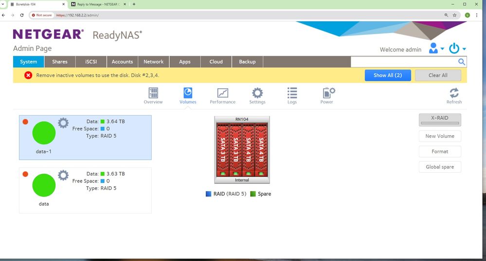

  • I have the same problem, and follow StephenB solution but not work. Did I make something wrong, please help!
