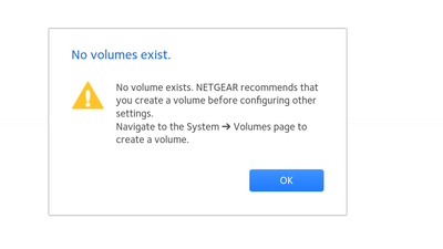

Hello,
I have a ReadyNAS 314 with firmware version 6.10.8.
Suddenly I was not able anymore to access the data stored in the NAS.
When logging in via web interface to the control panel of the NAS I see the following popup message. This issue was probably caused by a power outage that happened some weeks ago.  
I saw different posts about the same issue and, as suggested, I tried to contact the official support, but they said that they can't provide support for this old ReadyNAS. I saw some other posts with some commands to execute via SSH, but, to my understanding, my logs are different.
I don't have any backup of the data stored on the NAS.
Can someone help? Thanks!

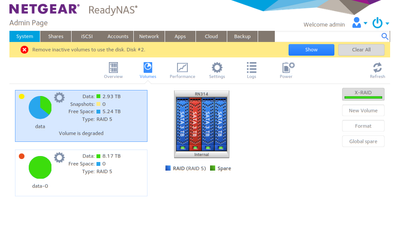

  • Hi StephenB,
    thank you for your answer.
    Following the advice of a friend that works in IT, I logged in via SSH and then executed these two commands:
    mdadm --assemble --really-force /dev/md127 /dev/sd[abcd]3
    mount /dev/md127 /data
    By doing so I was then able to see my data again, but one disk was still marked red as in the screenshot below.
    I then proceeded to format that disk and now the NAS is resynching.
    So it seems that the problem is solved.
    Thank you anyway for your availability.
