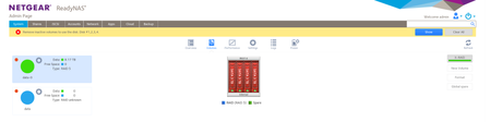

Following the advice of a friend that works in IT, I logged in via SSH and then executed these two commands:
mdadm --assemble --really-force /dev/md127 /dev/sd[abcd]3 mount /dev/md127 /dataBy doing so I was then able to see my data again, but one disk was still marked red as in the screenshot below.
I then proceeded to format that disk and now the NAS is resynching.
So it seems that the problem is solved.
Thank you anyway for your availability.
