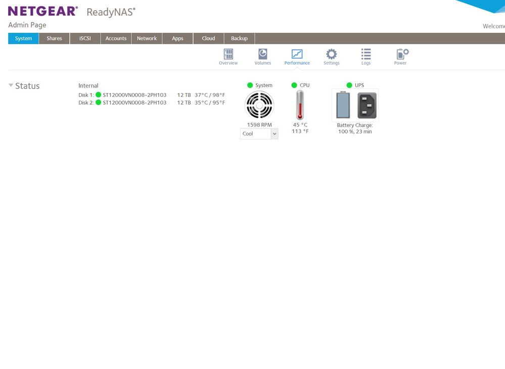

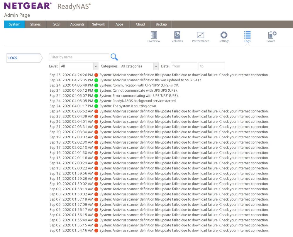

Just found two "issues" that may provide a clue:
1) Under "Performance" (see below) the usual Volume/Network/Utilization/Temperature graphs are completely gone. They show fine on the other two NAS boxes
2) The antivirus scanner update began logging an error in July and continued every day up to now, and still continues. Firmware is firmly up to date, and once I manually click on the antivirus scanner status, it then updates it a few minutes later. But then the next day, same issue. Read the 100+post thread on this issue, didn't find any magic answers other than rebooting the machine and keeping the OS up to date. OS has been up to date all along and I rebooted the machine yesterday; this morning, same issue. See below for the log list illustrating this.

Sorry not sure what's going on with the site... usually I can insert JPEG's into the message, this time it's not working so am attaching the two pics as files in two seperate posts.

The only ARM NAS I have is a 102, and I know it doesn't have the graphs because of insufficient RAM and/or CPU power, and I believe they are absent from all ARM units. The virus protection update issue does affect a lot of other users, and none have reported anything similar to your issue, so I don't think they are related.
Do the log entries you posted go back to a date you know the files were intact?
