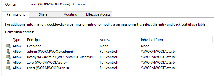

So i seperated out a user and that user is connected to one group
root@WormWood:/data/ztest# id zoro
uid=1030(zoro) gid=510(ostech) groups=510(ostech)
The user zoro creates a file from windows (right click to create new text document):
root@WormWood:/data/ztest# ls -l
total 0
-rwxrwx---+ 1 zoro users 0 Feb 11 15:13 zoro.txtWhy is the group "users" there and not the primary group "ostech"?
Windows 10 advanced security on the file
root@WormWood:/data/ztest# getfacl zoro.txt
# file: zoro.txt
# owner: zoro
# group: users
user::rwx
user:admin:rwx
user:zoro:rwx
group::rwx
group:admin:rwx
group:users:rwx
mask::rwx
other::---root@WormWood:/data/ztest# getfacl /data/ztest/

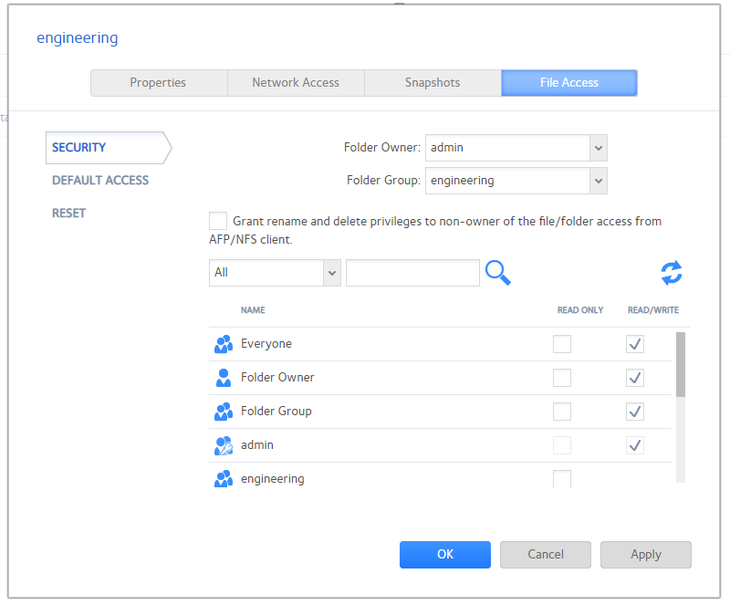

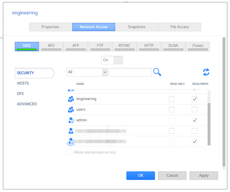

This's probably the most discussed question on various NAS vendors communities, being QNAP, Synology, or ReadyNAS. The users group is a default group where all users are members - explicitly or on most platforms impllicitly. Very similar to the "Authenticated Users" or "Domain Users" on an AD.
While QNAP and Synology don't offer it in the UI, ReadyNAS has the option to set a default or primary user group for the group. In my opinion, this does cause more confusion but added value. But then, there is - in my opinion - much more worng on the file protections on ReadyNAS (6.10-Beta1 including) when it comes to folder and files access rights (as effectively in place on the NAS itself).When creating a new shared folder, remove any default access (inlcuding the non-authenticated guest access) and only allow read+write to SMB for a group alos named engineering, this is the shared folder root holding the data
root@RN628X:~# getfacl /data/engineering
getfacl: Removing leading '/' from absolute path names
# file: data/engineering
# owner: guest
# group: guest
user::rwx
user:admin:rwx
user:guest:rwx
group::rwx
group:admin:rwx
group:guest:rwx
mask::rwx
other::rwx
default:user::rwx
default:user:admin:rwx
default:user:guest:rwx
default:group::rwx
default:group:admin:rwx
default:group:guest:rwx
default:mask::rwx
default:other::rwxCompletely wrong - the ACLs of the shred folder root do NOT reflect ... anything set in the access rights.

Of course, we can go and adjust - to some extent - the File Access for the shared folder:
Still, there are several more than strange file access items reamining, inlcuding the ReadyCloud cloud user(s):Granted, this does not break the access to the shared folder using the (only!) defined access by SMB - but it's simply wrong from the audit prospective. Reported this many times already during the ReadyNAS OS 6 Beta - still, file and folder ownership as well as ACL do not properly relefct the effectively intended access rights.
And you complain "just" about the default users group? That's just the peak of the ice berg.In my opinion, this is wrong bottom up and does prohibit any serious (IT audited) business use of ReadyNAS.
