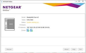

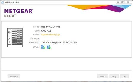

RND2000v2 (ReadyNAS Duo v2) stuck on 'system starting up' RAIDar
Hi All, I'm hoping someone can help me please. I'm pretty stuck and not sure what else to try. I have a ReadyNAS Duo v2 which has been working fine for a number of years. It has 2x3TB HDDs ins...
