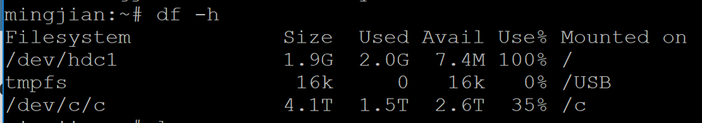

The first step is to ssh into the NAS, and look at how full the OS partition is.
# cd //
# df . -h
# df . -i
The assumes that you've enabled ssh in the NAS (installed the EnableRootSSH add on for your plaform). If you haven't already done that, the install might fail, since it does require some space on the OS partition. As a reminder, you log in as root, using the NAS admin password.
Normally the OS partition is about 20% full.

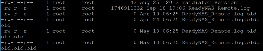

Indeed, as suspected the OS volume is completely full. The issue appears to be the 1.74 GB ReadyNAS_Remote.log file generated on Sep 18. Below is the OS file space use and the large log file:
Large log fileOS spaceIs there anything important in the log file? Is there a way I can copy it to an external USB thumb drive or the main partition?

- StephenBSep 25, 2018Guru - Experienced User
You can just delete it or truncate, and then reboot the NAS.
You can delete it using the rm command
# rm ReadyNAS_Remote.log
You can alternatively truncate the file to 0 bytes using
# echo " " >ReadyNAS_Remote.log
Either way, the file system is case-sensitve, so you do need to pay attention to the capitalization.
