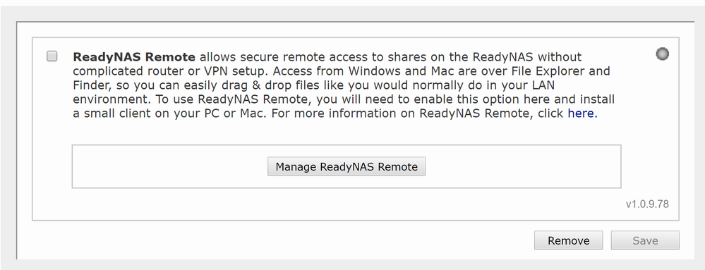

I checked in Frontview and ReadyNAS Remote is NOT enabled (refer to photo below), so I am not sure why it generated the huge file that filled up my OS.
ReadyNAS RemoteAnyways, now that things appear to be working properly, is there any reason to upgrade again the firmware to 4.1.16? Is there a significant difference between the firmware versions or vulnerability that needs to be addressed?
