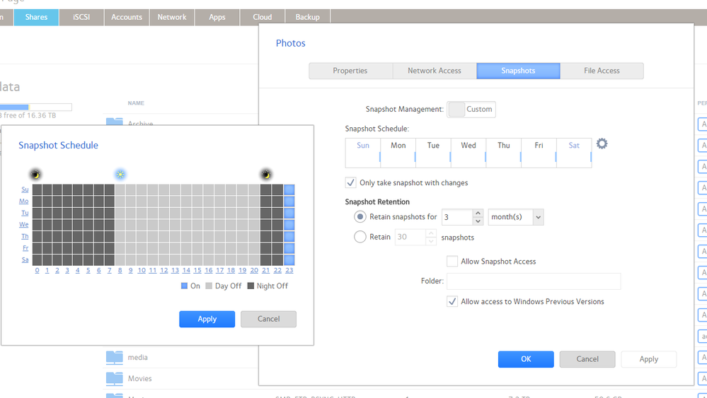

Do you have snapshots enabled on the share?
- KenTanker0us1Jan 05, 2018Tutor
On the (old) target share I wouldn't know how, so I doubt it has snapshots enabled.
On the new one, I don't think so. In share settings/snapshots, Snapshot Management is set to Smart, but it's greyed out. Shapshot Schedule is set to Never.
- StephenBJan 05, 2018Guru - Experienced User
I meant the new one, but it looks like they are disabled. Also I am assuming the size increase is on the new NAS - let me know if that is incorrect.
Did you look at the backup log?
Also, if the backup is running on the new NAS, can you post screen shots of at least the advanced and options tabs for the backup job? If it is running on the old NAS, post screen shots of at least Step 1 and Step 4.
I took your recommendation and I'm running the backup job on the new NAS; so the source is local and the destination is the 6000.
The size increase is on the old NAS - the target.
I did look at the backup log, but it didn't really clear anything up for me.
Screenshots from the new:
So I'm mostly happy, I just need to understand these backup jobs more clearly. What did I do wrong?
As always, thanks very much.
