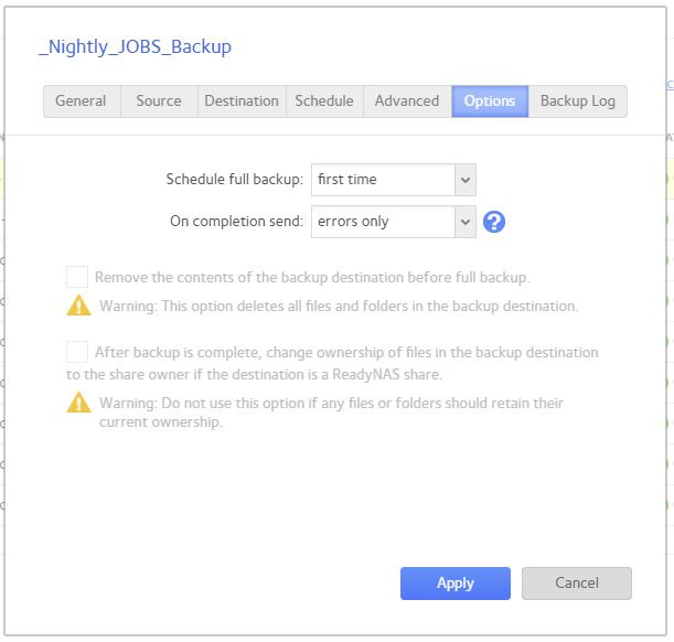

Screenshots from the new:
So I'm mostly happy, I just need to understand these backup jobs more clearly. What did I do wrong?
As always, thanks very much.
- StephenBJan 05, 2018Guru - Experienced User
I suggest setting "Remove deleted files on target". When that is set, if you delete a file on the new NAS, it will be deleted on the old when the backup runs.

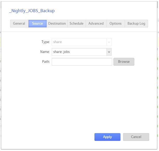

Look to see if there is a subfolder in the Pro share that matches the sharename.
- KenTanker0us1Jan 05, 2018Tutor
You were right: there is a folder called jobs in the jobs share. So it would be a duplicate of the share living inside of the share. Can I delete it?
I changed the settings for the backup job (on the new NAS) so now "Remove deleted files on target" is enabled.
Awaiting instructions, with thanks.
Yes.
That is where the backup actually went. You can fix that by going to source setting in the backup job and enter a / in the path field.
That is described in step 16 here, but is very easy to miss: https://kb.netgear.com/29741/How-do-I-back-up-data-between-two-ReadyNAS-OS-6-systems-using-the-backup-manager. An OS-6 quirk, though it can be convenient if you are backing up multiple shares to the same target share.

1. In the new NAS, where I'm running the backup job, I set the backup job settings/Source to be share:/jobs ??
Right now the backup job source is set to share:jobs. Here's a screen shot:
I went ahead and deleted that extra jobs folder, so the old NAS is happy.
The link should be fixed now. The forum software sometimes grabs an extra character or two when it creates the hyperlink.
No. I said to set to PATH field to /. Put the share name back to share:jobs.

My bad. I was looking at the name instead of the path. Duh!
I never changed the name, so no need to change anything back.
The link works now. Very useful.
I put the / in the path field. I fully expect the backup job to be good now.
