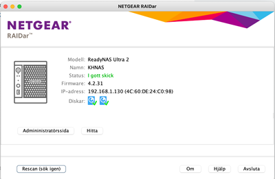

Is RAIDar giving you any useful status (version 6.5 is ok for this)

Raider looks like "I gott skick" which means "in good condition."

4.2.x firmware defaults to "admin" as the username and "netgear1" as the password. If those aren't working, then either you didn't do the OS reinstall correctly, or there is something else wrong with the web server running in the NAS.
