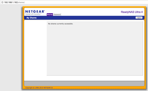

RNDU4000 Can't access shares
Hello, I purchased an ReadyNAS back in 2011 and was using it up until 2013 when I divorced. I just plugged it back in and tried to access via my macbook pro and could not. On the front of the ReadyN...

Let's not do the OS reinstall just yet.
That screen only means that you have no shares that are set up to use http as the file sharing protocol.
What happens if you enter https://192.168.1.162/admin ? You should get a username/password prompt. Do you know the admin password of the NAS?
Also, did you try using finder to connect to the NAS using it's IP address?

Wow - that did it! I was able to access the admin tool (pic below) as well as connect to my desired share via finder. I confirm that I was able to access my pictures. Thanks so much!
Would you recommend a firmware update or anything else to get it up to snuff before I start using it again?
