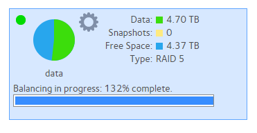

- SauvageSausageMar 08, 2022Tutor
Thank you, it did help! There is a strange thing with balancing progress tho but I believe nothing fatal:
- StephenBMar 09, 2022Guru - Experienced User
I've seen this myself - I think it happens when the volume has been vertically expanded in the past. But it isn't fatal.
- SandsharkMar 09, 2022Sensei
I hasve found that the ReadyNAS does not automatically do a balance after expansion (which is recommended when expanding a BTRFS volume), and that results in no allocation of metadata space on a vertically expanded volume. So, manually doing a balance afterward is highly recommened.
I've also noticed some inconsistancy as to whether the metedata is in RAID or DUP. You can find out with btrfs filesystem df /data.
From everything I've read, RAID is the best configuration. The following will change that: btrfs balance start -mconvert=raid1 /data
Of course, it's a balance, so it'll take a while.
