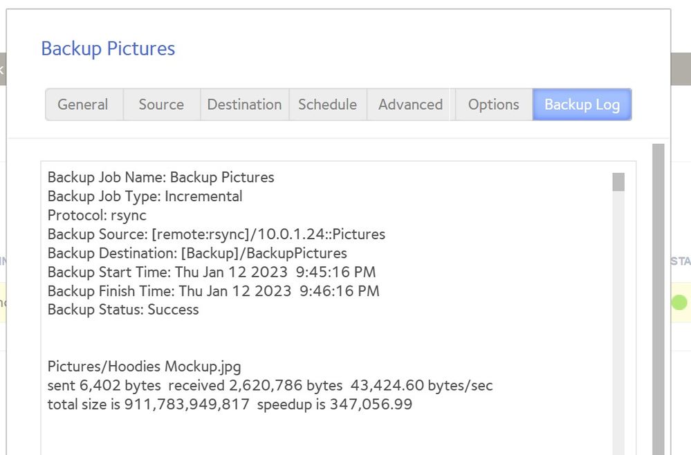

I have been using rsync to backup a large directory full of pictures from one ReadyNAS device to another. Or so I thought. I set it up some time ago, and clearly stopped checking it was working,...
- Jan 12, 2023
But the log says it is. I think they are being copied into Backup Pictures/Pictures because you have no trailing forward slash after the destination directory name.

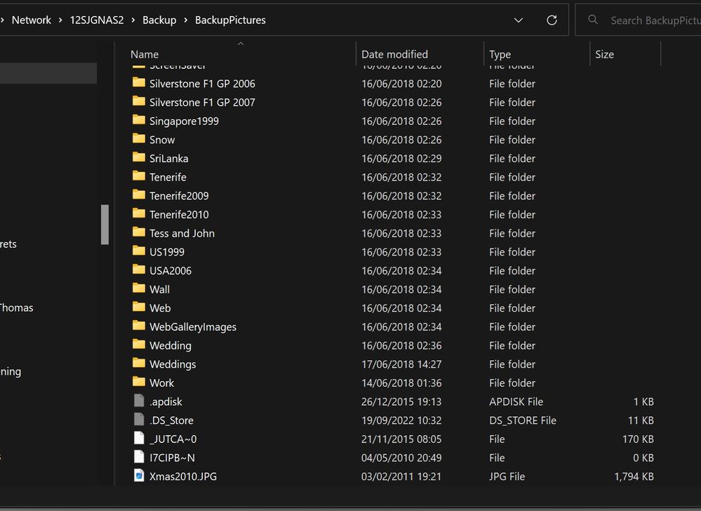

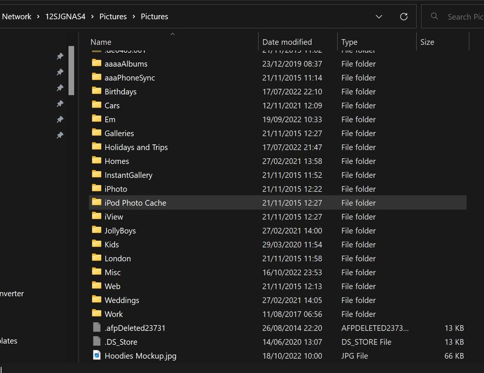

So it doesn't look like anything is actually being copied...dropped the file "Hoodies Mockup.jpg"
Started the backup and it looked to work....
Looks to have received it from the source share....
But nothing appears (refreshed File Explorer a few times...)
Could it be permissions related maybe?

Not so much an idiot, as the lack of the trailing slash is the default and the way the backup jobs do this isn't well documented. You have to actually go in and edit the destination after creation to add the slash.
Here is why it does what it does: Say you have ThisStuff and ThatStuff directories to backup with different backup jobs. If you back them both up to Backup and it put everything at top level, it'd get all mixed in. That would be especially a problem if you have it set up to delete files in the backup that are deleted on the source -- each job would delete the files of the last. So, it backs them to Backup/ThisStuff and Backup/ThatStuff. Of course, each job doesn't know if others exist, so it always backs up to a sub-directory named after the source. A trailing slash can be added to eliminate that, but you have to expressly do it, to assure that's what you really want.
Your first backup was likely by some other means (maybe drag-and-drop), so the files and directories you currently have at top level are very old (but a lot are probably duplicates). But their presence confused you as to where the newest stuff should be.
