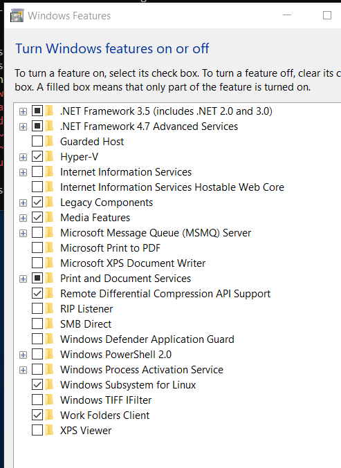

- ylafontFeb 05, 2018Aspirant
Tried that also, protocols are not listed in the list.
Had already tried most of these solutions to no avail usually i get this
Feature name SMB1Protocol is unknown.
A Windows feature name was not recognized.
Use the /Get-Features option to find the name of the feature in the image and try the command again.also tried
Enable-WindowsOptionalFeature -Online -FeatureName smb1protocol
and no go.
Pretty much not matter what i tried, i could not install it.
- StephenBFeb 05, 2018Guru - Experienced User
Do you see it listed when you look in "turn windows features on or off"?
