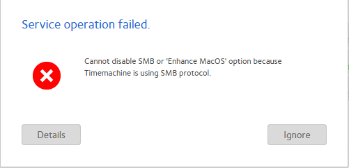

I can't disable EnhanceMacOS because one of the phones being backed up is an iPhone using TimeMachine over SMB (which has no problems I'm aware of).

- PlainBillJan 24, 2019Tutor
I tried disabling it to test, but it apparantly won't let me:
Hi Stephan,
Disabling both Timemachine and the Enhance MacOS settings fixed it for me.
Suggest you set up a shared Timemachine, enable Enhance MacOS (if it doesn't automatically do it for you) and retest, please.
So on the assumption it's something to do with Timemachine, I need a solution that includes providing the Timemachine service for iBook/iPad that doesn't interfere with SMB like this.
Regards, and thanks for your help
Bill
