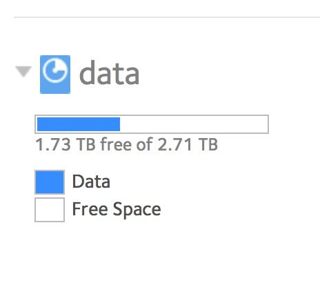

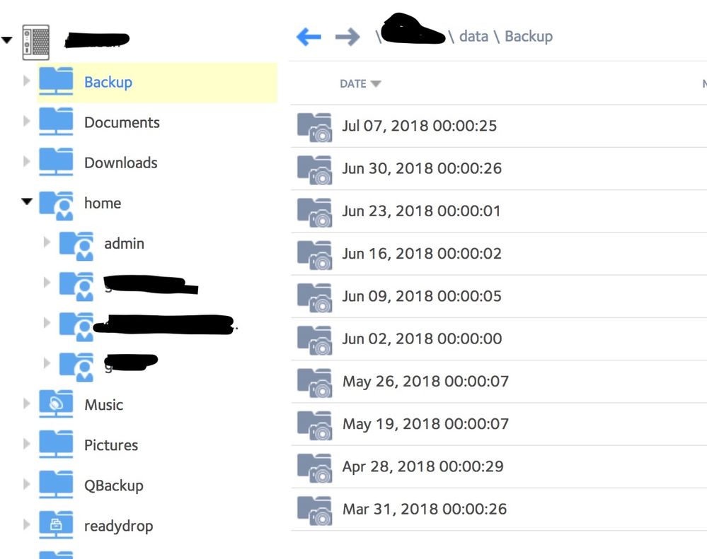

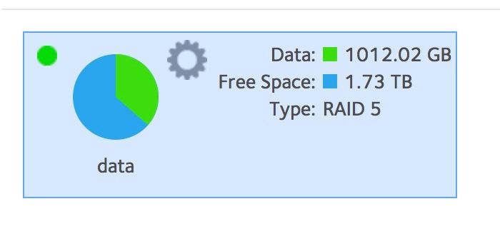

After a recently scrub operation, Snapshot statistics no longer appear in FrontView. However, when I go to the Snapshots of a particular share, all the snapshots appear to be present.
In the attached screen captures, you can see in #1 and #2 that no snapshot space is indicated.

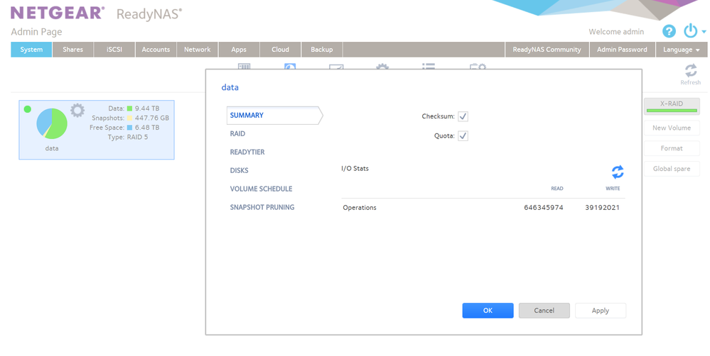

However in #3, you can see that the snapshots are clearly present.
Any clue as to what might be going on?
  • I suspect that volume quota was disabled somehow.  Go to the volumes page, and click on the volumes setting wheel.  Then enable quota there.
2 Replies
  • StephenB's avatar
    StephenB
    • RupertGiles's avatar
      RupertGiles
      Apprentice
      BINGO!
      I'd turned off Quotas at part of the solution for dealing with a slow Scrub process.
      Thanks!
