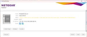

Swapped out 2 x 4TB WD Red HDs from failing RNDuoV2 and installed into new RNDuoV2
Hi Sandshark & StephenB 1) Sandshark Last September, 29th to be exact, you gave me some good advice as a solution to my failing RNDuoV2 problem. That advice was:- "b) Try to buy ano...
StephenB
Dec 05, 2024Guru - Experienced User
ukbobboy01 wrote:3) Finally, the yellow texts. I believe that if I can get FW5.3.13 installed (again) this should clear up the problem.
I don't think the yellow text is related to the firmware being detected. It is saying that the RAID array is not redundant. It's not clear why that is, since RAIDar isn't saying that it is syncing.
ukbobboy01 wrote:
I have now fully implemented your advice and, to some extent, it has worked, as I can now see my plex files again (not tried to play/view them yet) but I cannot access this new RNDuoV2's dashboard.
What error are you getting when you try to access the dashboard.
It sounds like you can access the files on this NAS with SMB/Windows File Sharing. Is that the case?
If it is the case, have you backed up the data on the NAS? I think making sure the data is safe is higher priority than accessing the dashboard and updating the firmware.
