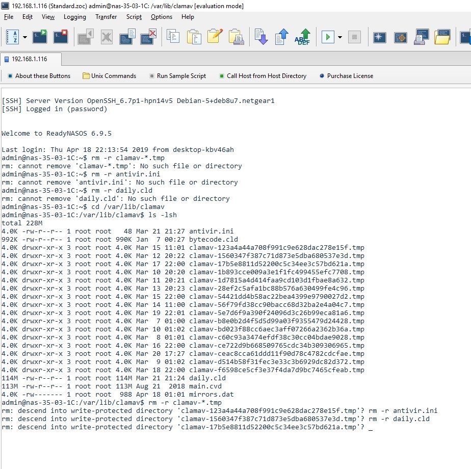

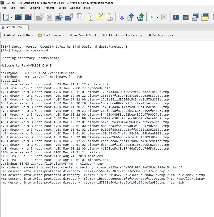

How to fix the error? Everything is slowly working!- dasgwegApr 18, 2019Aspirant
I am from Russia, I don’t understand English at all! Especially your terms. It is possible for all guys who have the same problem, and they are common, to record a video with the instructions! ?? I personally can not understand anything at all, according to your instructions. I would be very grateful if this is possible. If I perform this operation, will I lose the data on the disk? thank
Что я не то делаю? ничего не меняется. Ввожу как у Вас. Сначало
cd /var/lib/clamav ls -lsh
and
rm -r clamav-*.tmp ls -lsh
and
rm -r clamav-*.tmp
rm -r antivir.ini
rm -r daily.cld
