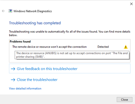

The device is not set up to accept connections from port "The File and printer sharing (SMB)"
Hi! About two weeks ago I had a blackout at my apartment and when I got home and turned everything on again I was met by this message when I tried to connect to my NAS: At first I tried to go...

So how do I fix my NAS now that the data is off-loaded?
You can do a factory default using the front panel, which will set up the NAS from scratch. The process is described on pages 15-16 here: https://www.downloads.netgear.com/files/GDC/RND2110/Duov1_NV+v1_HW_en_06Dec11.pdf It might take about 30 minutes to come back on-line after the process begins.
After you regain connectivity, set up the NAS again and restore the data from your backup.
StephenB
Aug 03, 2021Guru - Experienced User
