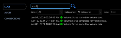

So, I decided to do a little preventative maintenance on my RN516, LOL:

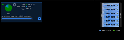

It still has not finished, June 18th @ ~3pm Central time currently:
As you can see, the last time I ran a scrub, it finished in a couple of days (more or less). Looks like it was about 60% utilized at that time. Now I'm looking at 11 days (and counting). đŹ

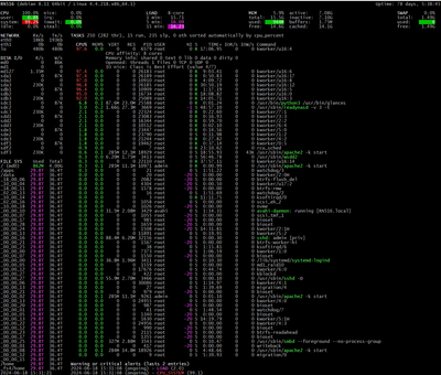

It's interesting though, because all 8 threads of the CPU are running near 100% utilization during this entire time, but the disk throughput is very low. There is nothing else running on this array, but it is about 80% full. Memory usage is squat.
It's primarily the backup target for my Veeam agents, and ReadyDR from my RN316. Veeam is pretty unhappy with it right now, as most of the backups are failing (presuming due to high latency from the maxed out CPU). But, ReadyDR seems fine with it. Hopefully it'll be done within the next day or two so I can turn my Veeam agents back on.
