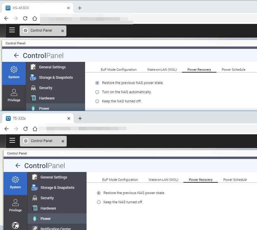

If you are interested: The competitors are not sleeping - they have controls in the Web UI for BIOS- (top) and custom power controller equipped ARM systems (below) for a loooong time:- ReadyASDec 14, 2019Guide
