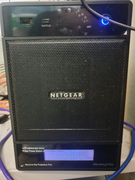

I suggest powering off the NAS and removing the mains power for a few minutes. Then try a fresh boot. If the LAN LED still doesn't light, try switching to the second LAN port.
On the boot menu, I am wondering if removing the plastic would help. It's possible it is interfering with the button press.

For my model, I would like to know the the boot menu selection is indicate by the disk LED (1, 2 3, 4) or it will showing the syntax on the display?
I have pressing many times "backup" button, but there is not any word(s) changing on the display or even the LED light switching between 1 to 4.
- StephenBNov 18, 2024Guru - Experienced User
You should see it on both the display and the LED lights.
- SandsharkNov 19, 2024Sensei
It sounds like one of two possibilities: The backup button is broken or the syslinux.cfg file in flash is corrupt. It's probably worth a try doing a USB recovery, which should fix the latter.
