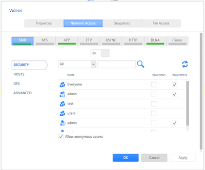

You may have to enable DLNA on the shares you have set up. You can do that by going into settings of the share and enable DLNA under Network Access. You will then be able to see the share/folder on the Samsung TV.

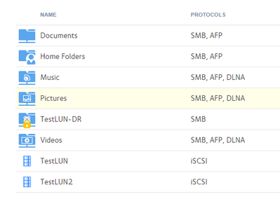

The folders you are seeing on the TV have DLNA enabled
So you need to enable DLNA on the folders you want to be accessible to your TV.
Just click on the COg on the right side of your Share/Folder and access the Settings. Under Network tab, Enable DLNA
But only Supported files will be showing once you have access to this folder.
Hope this helps!
