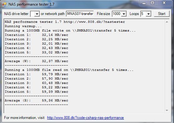

For RN104:
Running a 400MB file write on \\PMNAS01\transfer 5 times... Iteration 1: 31,36 MB/sec Iteration 2: 32,98 MB/sec Iteration 3: 33,64 MB/sec Iteration 4: 33,72 MB/sec Iteration 5: 32,22 MB/sec ----------------------------- Average (W): 32,79 MB/sec ----------------------------- Running a 400MB file read on \\PMNAS01\transfer 5 times... Iteration 1: 57,58 MB/sec Iteration 2: 58,93 MB/sec Iteration 3: 57,70 MB/sec Iteration 4: 57,93 MB/sec Iteration 5: 56,61 MB/sec ----------------------------- Average (R): 57,75 MB/sec -----------------------------
i tried restart outh NAS units, router, switches... nothing help.
