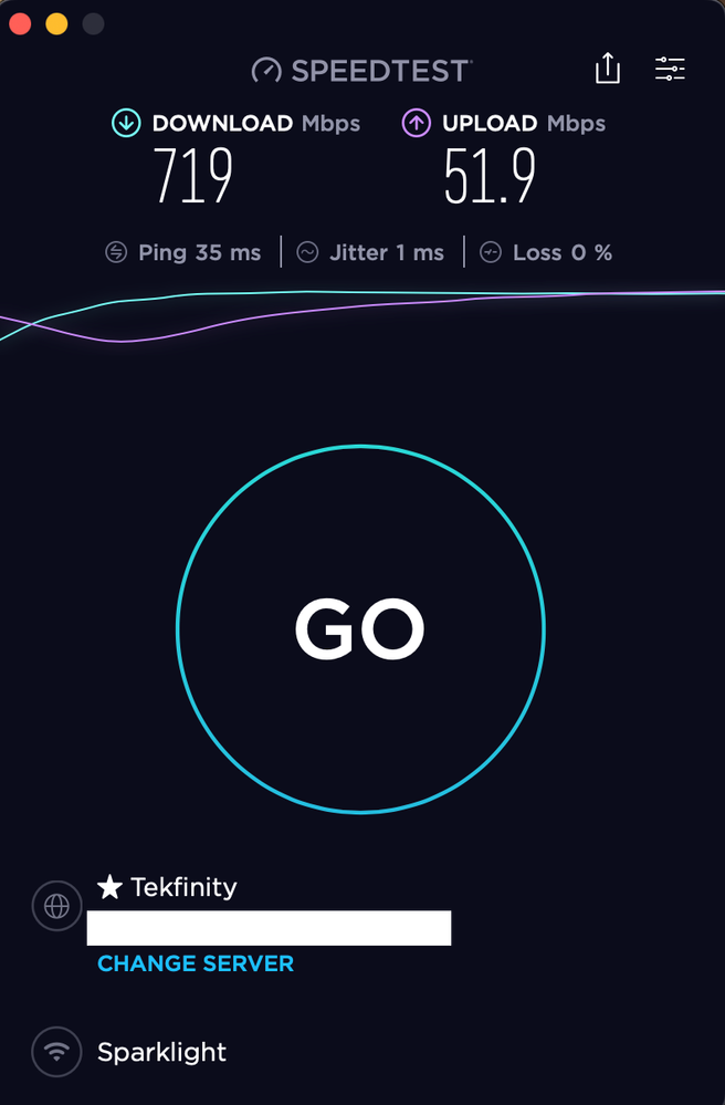

What I see with my Mac Book Pro 2018 and my XR1000 today:
Pretty good for 5Ghz AC which is top of the range for 5Ghz AC
