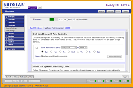

Volume Maintenance scheduled jobs stopped running
Hi. I have scheduled maintenance jobs (see attached), which have run happily since I installed the ReadyNAS, but for a few months now they have not been running (log attached). I can't put a precise ...

Firmware is 4.2.31
I have rebooted and run the jobs several times since it started but still seems stuck...
My hunch is a firmware update that's done it but it's only a hunch
Maybe I could try to reinstall?

- straffJan 21, 2019Aspirant
Yes I did try disabling and reenabling... I've tried pretty much everything over the weeks (months now), except the reinstall so that's where I'll go next I think.
Well, that (firmware update) seems to have done the trick - I set a schedule for 11 GMT today and it's currently in progress.... fingers crossed. Thanks for the input
- straffJan 27, 2019Aspirant
Final confirmation reset the schedule to early Sunday as before, and received the confirmation emails... so all back to normal :)
