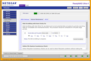

Volume Maintenance scheduled jobs stopped running
Hi. I have scheduled maintenance jobs (see attached), which have run happily since I installed the ReadyNAS, but for a few months now they have not been running (log attached). I can't put a precise ...

straff wrote:
Firmware is 4.2.31
My hunch is a firmware update that's done it but it's only a hunch
I've been running 4.2.31 for a long time now, and the maintenance functions have been working for me.
You could try disabling the functions and re-enabling them (if you haven't done that already).
You could of course try an OS reinstall, though I think I'd try an over-install of 4.2.31 from the web ui instead.

Well, that (firmware update) seems to have done the trick - I set a schedule for 11 GMT today and it's currently in progress.... fingers crossed. Thanks for the input
- straffJan 27, 2019Aspirant
Final confirmation reset the schedule to early Sunday as before, and received the confirmation emails... so all back to normal :)
