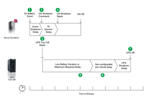

Have been testing the APC UPS Back-UPS RS 1200G with RN312 and it works well in the sense that based on the threshold 30% I set in the ReadyNAS Admin page, the RN is shutdown when battery charge is below 30%. That threshold of 30% will also shows up in the upsc output.
# upsc UPS@localhost ... battery.charge.low: 30 ...
I was expecting the UPS to also shut down (a short while) after the server shuts down. There's no need for the UPS to supply battery power once the RN is switched off. All other devices can also lose power at that point. The APC PowerChute manual (990-4595E-001 07/2016) depicts this on page 36:
But I didn't see this during my test happening for over 20 minutes after server shutdown and didn't dare wait until the battery was fully drained. So this leads me to a few question. Hope you can help!
1) Is it expected behaviour of the UPS be shutdown shortly after RN is shutdown?
2) How long should I wait for the "UPS off" (point 7) to be reached?
2) Will ReadyNAS OS "tell" the APC UPS to start the shutdown procedure? (point 2 in image above)
3) Is there a way to influence the Low Battery Duration / Maximum required delay? (point 5 in image above)
4) Is there a way to influence the UPS Shutdown Delay? (before point 7 in image above)
