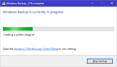

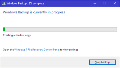

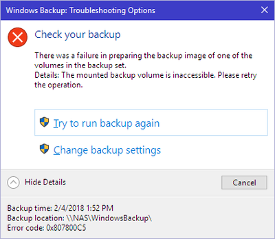

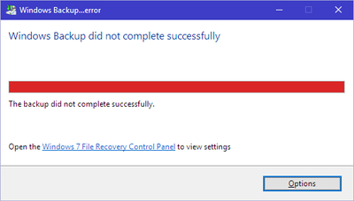

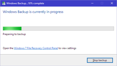

When going through the config process of Windows Backup I am able to select the NAS as my network location and select the folder that I have created as the Share from the ReadyNAS interface (WindowsBackup is what I have named the share). Windows Backup then asks me to confirm the username/password. If I supply a bad username/password combo it notifies me. I then tell the app to start the backup and below is a summary of what happens:
From start to finish it takes about 3 minutes for the backup job to fail.

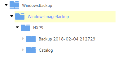

The strange thing is that if I browse to the backup location on the NAS I can see the following:
Data is being written, and then it errors out.

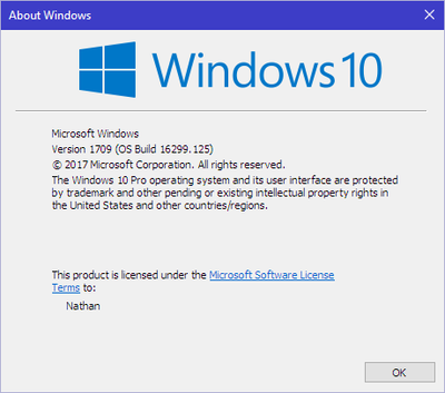

The version of Windows I am running is:
Any help would be greatly appreciated. I login to my computer using a Microsoft Account, which happens to use the same email as my MyNetgear account, but with a different password, so I'm not sure if that is causing any issues. I know that before I upgraded my account to a ReadyCloud account things were easier because my new ReadyCloud account wasn't automatically downloaded to my ReadyNAS so I could use different passwords and access my shares via SMB without an issue.

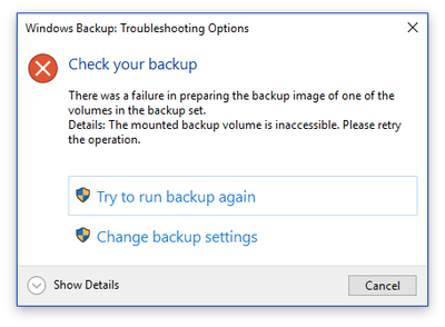

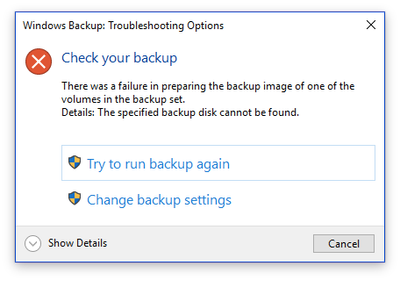

      I have a VM running in Parallels on my Mac. Version of Windows 10 is 1709 Build 16299.125. The data on the hard drive in the VM is 16 GB. I began the backup setup process and connected it to the NAS using the same username John and the password. I then began the system image backup and it errored out within a minute or so with the following error message.
      I ran the backup a second time (as this was the same first error I received on my other computer as well) and this is the result.
      Same error I received on my main computer.
