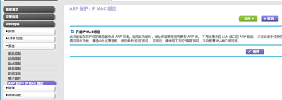

R6900 ip mac bind cause no Internet
version: V1.0.2.26_10.0.45
upnp : on
port forward : on ,
but not working because dhcp ip with my pc lost when pc shutdown after some time ,if dhcp ip not lost that wake on lan will success.
i think reserved IP but not enable ip mac binding will cause the wake on lan problem. but when i enable ip mac binding i can't use some app (some can be used)
  • rollback to the version:V1.0.2.6_10.0.37 will fixed the arp ip-mac binding problem

    • kokokobe's avatar
      kokokobe
      yes i wan to wake-on-lan my pc and remote connect it.
      that is ppoe moden. i'm sorry for my pooly english. i try bind ip and mac address then can remote wake on my pc . but critical bug with bind ip and mac address. I remote connect the pc but always lose connection. becase the enable it can effect the lan assign.
      but i can remote control the router web control backend.
    • kokokobe's avatar
      kokokobe
      i find some same report in this forum . that's ip mac binding big bug as my try . how to report this?
