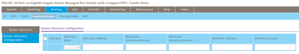

That’s the first thing I had in mind but I don’t seem to be able to do so: The only “discover” settings I could find are the LLDP settings (unlikely, but anyway, I turned LLDP off on all interfaces because there’s no global setting to shut it off but nsdp still ran and hogged the CPU), and “Router Discovery”.
On the “Router Discovery” page there’s just a single row of settings, which incomplete: There’s no “Interface” to select:
But I suppose that’s because the switch does not act as a router; we don’t need this, we just need a 10G switch.

Well, turning (IP) routing on didn’t change the settings which are available on the “Router Discover” page.
