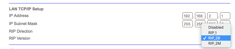

Current firmware: V2.0.0.76
In Advanced LAN Setup, there is currently the option to use RIP1 or RIP2 protocols:
However, these protocols only support IPv4. In order to support routing IPv6, there is also a need to support RIPng (RFC 2080), otherwise, static routing is necessary. Unfortunately, static routes in an environment with dynamically allocated IPv6 prefix delegation is not a good idea - it would be much better to use RIPng and not have to manage (potentially changing) static routes.
Given that there are already multiple RIP protocols supported, the addition of RIPng seems like it should be a relatively simple change.
