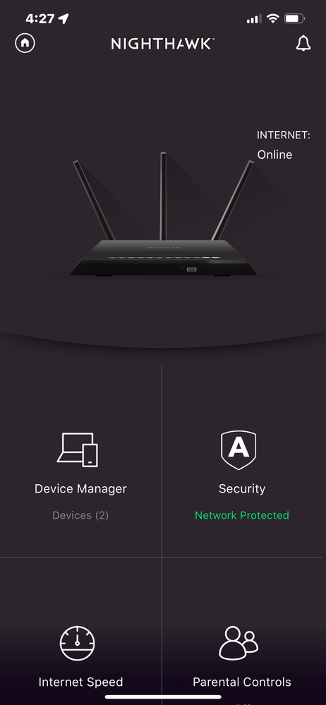

  4. Opened up the NH app. App was Detecting Product for a bit.
  5. Finally displayed the white log in screen. I entered in admin and password knowing that this is the same default for using the routers web page in a browser. The app continued and began the setup wizard process.
  6. I walked thru the setup wizard process. I didn't change the SSID name or password.
  7. I changed the admin password to something else and simple enough to be the criteria. Entered in security questions.
  8. Continued thru the setup wizard and finally, the app connected and was displaying the R7000 home page on the app.
  1. After the app was connected, closed the NH app and opened it again to be sure it would re-connect. It did, however I noticed it used the Cloud to access the routers page. I selected local access and it connected fine.
  2. I enabled Smart Connect using the NH app and the phone reconnected as well as the NH app.
