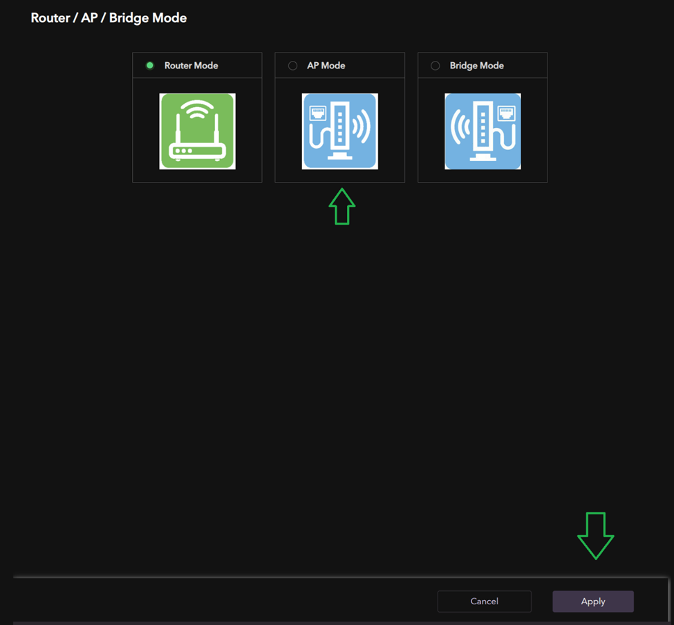

Log into the NETGEAR routers web page at 192.168.1.1 or the IP address custom set if this differs from the default IP address, in a web browser. Navigate to the following location, Advanced tab/Advanced Setup/Router/AP Mode menu setting. Also, may be seen as Router Mode on some different model routers.
Select on the AP Mode tile to select this mode for the NETGEAR router.
Then select the APPLY button.

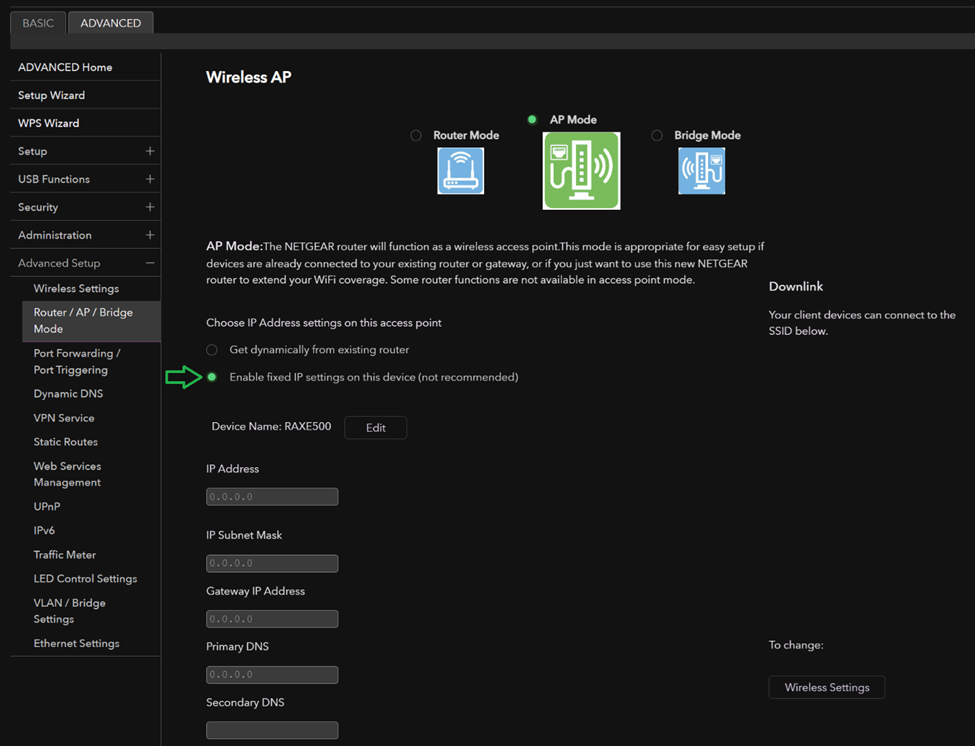

Wireless AP configuration screen will appear in the web page:
Select the Enable fixed IP Settings on this device radio button. This will display the IP Address, IP Subnet Mask, Gateway IP Address, Primary and Secondary DNS configuration input boxes:
Configure the IP Address box for a static IP address number that is outside of the host routers DHCP IP Address pool range. Recommend setting the default DHCP IP address pool range to the following after applying and a factory reset: 192.168.#.100 to 192.168.#.200.
Example:
Host router Default IP address pool range is set for 192.168.0.100 thru .200.
IP Address set on NEGEAR router for AP mode is 192.168.0.50
Recommend making the static IP address intuitive. i.e. use the model number of the NETGEAR router in the IP address number in the last value. So, for a RBR850 or RAX120 model router, set a 192.168.#.85 or 192.168.#.12 static IP address. This IP address will not change unless the user changes it here. These addresses need to be outside of the host routers DHCP IP address pool range.
Configure the IP Subnet Mask, Gateway IP Address, Primary and Secondary DNS configuration input boxes accordingly to what the host router is set for.
Example:
Host router IP Subnet Mask is 255.255.255.0
Host router Gateway IP Address is 192.168.0.1
Primary and Secondary can be either the Host routers IP address or use custom DNS IP addresses here, such as ISP service DNS, Google DNS, OpenDNS, Quad 9 DNS, Raspberry Pi DNS or any other valid DNS addresses can be used here.
After input boxes have been filled in correctly and checked, select the APPLY button.

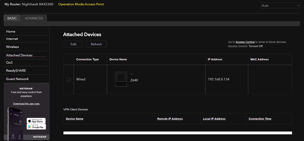

Navigate to Basic Tab/Attached Devices. Verify any devices appear here that are connected to the NETGEAR router while in AP Mode. All ethernet and wireless connected devices will appear here:
