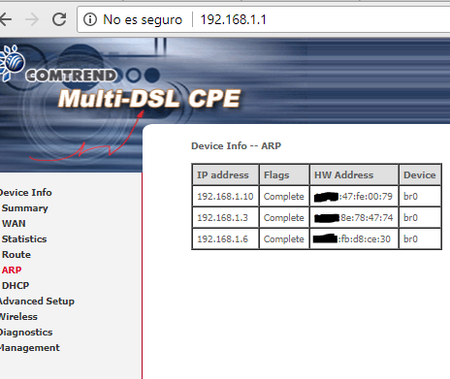

Hi everyone, I´ve been using a shared hard disk in my local network and this is my very first time using a NAS and I cannot find the way to configure it. It´s been a couple of days since I´ve been setting it up but there is nothing else I can do. I have tried a couple of possible solutions but nothing worked so I am going to tell what I have done and see if you can help me. am using the hard drive I used for local network, and I just want to let you know that I only store movies on it so I don’t use it that much and it has got more or less a year since I bought it. So, I formatted the hard drive which is a Seagate ST2000DM001 and inserted in the chamber 1 of the NAS. After turning it up it did nothing, I wasn´t able to find it in the Ready Cloud web page, also pressed the backup button for 5 sec. and nothing. I also downloaded the RAIDar programme and still the same. As I remembered I set to my tech a static IP so I thought it would be because of that so I set the NAS with the 192.168.1.10 to the eth0 and 192.168.1.11 to the eth1. I do have the NAS connected the router my internet provider gave as I also have a switch and thought this could cause some issues. I can ping the ip from my PC sending 4 packages and receiving them too, I have also tried looking up they IP through the browser and nothing. So, I thought it would be a problem with the hard disk so I decided to formatted using this manual selection Factory default and leave it "think” for 30 min; useless.Right now, it has the power button blue and the rest are off. I´m also going to post some photos as they may be useful. Any help is welcome and thanks in advanced.Configurar Nas
Hola a todos, primera vez que tengo un NAS y no veo manera de configurarlo, venía usando hasta ahora un disco duro compartido en red. Llevo un par de dias intentando poder llegar a configurarlo pero todo es en vano. He probado bastantes cosas y nada, no avanzo por lo que os comento que he hecho para ver si me podeis indica que me he podido dejar. Estoy reutilizando el disco duro que usaba antes (Seagate ST2000DM001) a penas de 1 año tendá y lo uso para meter archivos pesados estilo peliculas y no tenía el SO ahí instalado asi que poca caña le he dado. Lo formateé despues de guardar todo el contenido y lo meto en el NAS bahia 1. Tras encenderlo y ver que no hacia nada, no lo encontraba en la pagina web Ready Cloud probé a pulsar el boton de backup 5 segundos y nada, descargue el programa RAIDar y tampoco.Como trasteé hace unos años con las IP y las MAC de mis equipos añadí a las tablas de enrutamiento del router las MAC y asigné las IP a las dos tarjetas de red. En este caso puse la 192.168.1.10 a la eth0 y 192.168.1.11 a la eth1.Actualmente tengo conectado el NAS al router de mi proveedor a que quite el switch por si era por eso el fallo y el ordenador desde elque lo estoy configurando también. Hago ping a la ip me responde, 4 enviados 4 recibidos. Busco la IP en el navegador y nada por lo que he optado a pensar que no estaba formateado bien el disco por lo que he tirado de este Manual y he seleccionado la opcion Factory default y lo he dejado una media hora por si acaso, pero nada. Ahora mismo solo esta la luz de power en azul fija y el resto apagadas. Pego alguna informacion que entiendo que puede ser relevante.Alguna idea de que puedo estar haciendo mal? Gracias de antemano.3.1KViews0likes1CommentNAS RND2175 (freebox)
