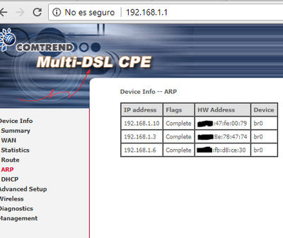

As I remembered I set to my tech a static IP so I thought it would be because of that so I set the NAS with the 192.168.1.10 to the eth0 and 192.168.1.11 to the eth1. I do have the NAS connected the router my internet provider gave as I also have a switch and thought this could cause some issues.

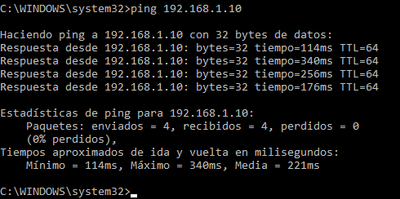

I can ping the ip from my PC sending 4 packages and receiving them too, I have also tried looking up they IP through the browser and nothing. So, I thought it would be a problem with the hard disk so I decided to formatted using this manual selection Factory default and leave it "think” for 30 min; useless.Right now, it has the power button blue and the rest are off. I´m also going to post some photos as they may be useful.

      Disconnect eth1 for now, and just use the one ethernet connection.  If you want to use two, you need to configure NIC teaming in the NAS - let's wait on that until you get everything else up and running.
      Then try entering http://192.168.1.10/admin into your PC browser, and see if you can log into the NAS.  There likely will be some security warnings that you need to click through.  When you get to the login screen, enter admin for the username and password for the password.

        I don't know if I didn't explain myself but I didn't mean I had connected two ethernet cables to the NAS. I just have one RJ45 but both eth ports configured in my DHCP table in my router just in case the problem I had was because I didn't have it set it up.
        Tomorrow I'll try accessing with the admin you told me and let you know.
