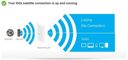

RBR50 & RBS50 Firmware V1.8.0.6 - Router and Satellite Came across this the other day, I logged into the RBS50 to see what I could see, I noticed that the image on the main page showed the status of the connection. 2.4GHz and 5.0GHz. In the image below, you will see the 5.0GHz shows as connected, and the 2.4GHz frequency shows (No Connection). This isn't explained very well anywhere, I was initially of the thought that the 2.4GHz band wasn't connected right, then I remembered the Orbi has a dedicated band to connect to the router from the satellite. This simply states there are no devices connected on the 2.4GHz frequency on the RBS50 (Satellite). If someone from Netgear happens to read this, maybe update that to read: (No Connected Devices) or (No Devices Connected) Just in case someone thinks the satellte isn't working properly like I did for a couple minutes.... ok, days... until I had time to dedicate to looking at this. Help this helps someone. SteveALERT TO USERS RBR50/RBS50 you may have to do a manual FIRMWARE update
