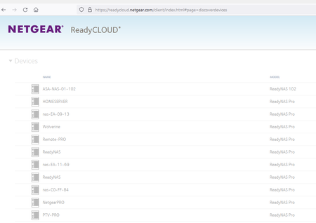

linking to --> community.netgear.com/discussions/readynas-use/remove-readycloud-users/2335016 (that is where I first saw the solution posted) I tried the various commands written at the end of the post linked above. I tried it in production, like proud, brave, foolish people do and it WORKED!!! I'm finally rid of the Readycloud users. It does not let me post the code, so you'll need to get it from the community post linked above. mv /opt/readycloud/etc/registration.conf /opt/readycloud/etc/registration_tmp.conf sed -i.bak '/^[[:space:]]*invalid user/d' /etc/frontview/samba/Shares.conf sed -i.bak '/^#/!s/^/#/' /etc/frontview/samba/usermap.conf sed -i.bak2 '/[@]/d' /etc/frontview/samba/usermap.conf find /data/._share -type f -name samba.conf -exec sed -i.bak '/^[[:space:]]*invalid users/d' {} + sed -i.bak '/@/d' /etc/samba/smbpasswd sed -i.bak '/^[^:]*@[^:]*:/d' /etc/passwd sed -i.bak '/^[^:]*@[^:]*:/d' /etc/shadow reboot ChatGPT explains it better than me: 1.- ReadyCLOUD disabled by moving: /opt/readycloud/etc/registration.conf -> registration_tmp.conf 2.- Samba configs cleaned: 3.- Removed invalid user(s) lines from Frontview and per-share configs. 4.- Commented out most of usermap.conf and deleted lines containing @. 5.- Purged @ users from /etc/samba/smbpasswd. 6.- System accounts with @ in the username deleted from /etc/passwd and /etc/shadow. 7.- System reboot I think you need to be careful if you have AD / domain integration on your NAS, because of the users with the @. If not it seems quite safe and effective. Tadá! NETGEAR please make OS6 open-source, what do you care? you don't even commercialize it anymore.454Views2likes3CommentsHow to create ReadyCloud
