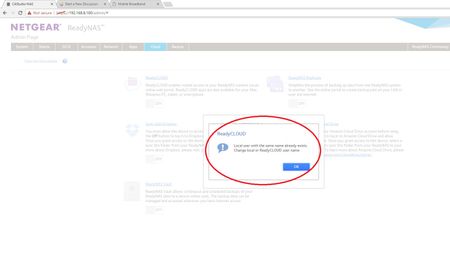

Hi all, I am having an issue when logging into ReadyCloud so as to enable the service for remote access. When I input the (correct) email and password I get the error below, I tried restting my password (if it makes any difference) but the issue persisted; I made sure that none of the users created clashed with regards to name or email address used and they dont and yet I cannot seem to get it working(image below). Device: ReadyNAS 104 OS: 6.6.1 Enivronment: 3 person office I appreciate your assistance Many thanks in advance Best regardsSolved4.9KViews0likes11CommentsHelp....I can access configuration but not my files :-(
