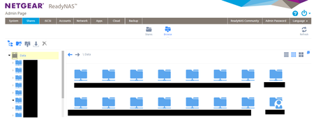

ReadyNAS 314 running on 6.6.1 and using Active Directory The issue that I'm having is that when I attempt to drill down into shares in the Share section of of the admin page, nothing happens aside from the progress bar moving temporarily and then disappearing. When viewing the files in Windows explorer, I am not having any of these issues. This behavior is happening in both the current Shares view as well as the recovery view. It is happening with all shares. I am logging into the admin page with the ReadyNAS built-in admin account. This wouldn't be a problem aside from removing my ability to be able to recover specific files and folders within each share. I noticed this last week, but it could have been an existing issue since we moved over to active directory a couple of months ago. It seems like it might be an AD permissions issue, but I'm not sure. What do you guys think? Thanks in advance for any assistance you can provide.2.7KViews0likes2CommentsReadynas 1100 Active direcrory option is not found
