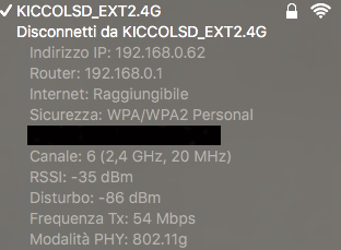

I’m using the EX6200 as AP with the latest firmware and I’m experiencing a strange issue: Both my Macs (One IMac 09 and one MacMini12 both with OS X 10.11.1) report “a” protocol link with 5Ghz and “g” link with 2.4Ghz. In both band speed is extremely slow. I suspect that even if AES encryption is setted in the extender gui, TKIP is used. An easy proof of this is my main router reporting TKIP encryption on both EX6200 WLANs. The only way to set AES is to choose both TKIP and AES but in my opinion TKIP is better when is set off. I hope someone could forward this to developes in order to fix. Regards3.9KViews0likes6Comments
